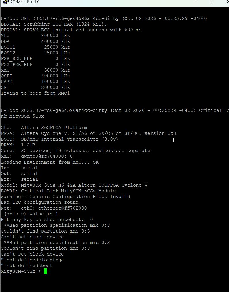

BNSD image not booting Kernel after shifting design from MitySOM-5CSX-H6-42A to MitySOM-5CSX-H6-4YA
Added by Bob Nayar about 2 months ago
I had successfully built images for the MitySOM-5CSX-H6-42A with the Mike's help on this forum.
However, after shifting my design to the MitySOM-5CSX-H6-4YA (and of course, re-doing the project from the Critical Link GIT repo 'dev_5csx_h6_4ya' folder), I am getting the messages shown in the attached image.
Do you know what I could be doing wrong?
Thanks.
Bob N

MF RE: SD image not booting Kernel after shifting design from MitySOM-5CSX-H6-42A to MitySOM-5CSX-H6-4YA - Added by Mike Fiorenza about 2 months ago
Bob,
The errors in your screenshot are the same line ending issue I described here: https://support.criticallink.com/redmine/boards/47/topics/7453?r=7483#message-7483
Your new dev_5csx_h6_4ya folder is a fresh checkout, so its uBootMMCEnv.txt.orig has Windows line endings again. Run this in that folder, then rebuild the image:
dos2unix software/preloader/uBootMMCEnv.txt.orig
make sd_image
The mmcfdtloc difference you found is expected. The Makefile points each module at its own device tree, and socfpga_mitysom5csx-h6-4ya_devkit.dtb is the right one for the 4YA, so leave that as is.
BN RE: SD image not booting Kernel after shifting design from MitySOM-5CSX-H6-42A to MitySOM-5CSX-H6-4YA - Added by Bob Nayar about 2 months ago
Thanks, Mike.
The DOS2UNIX (which I should have remembered) fixed it.
