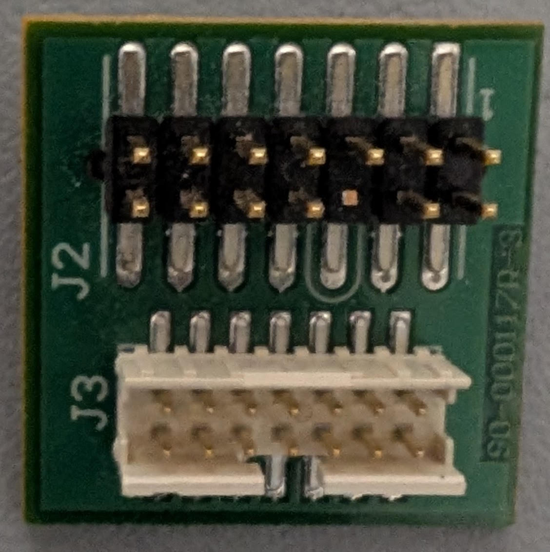

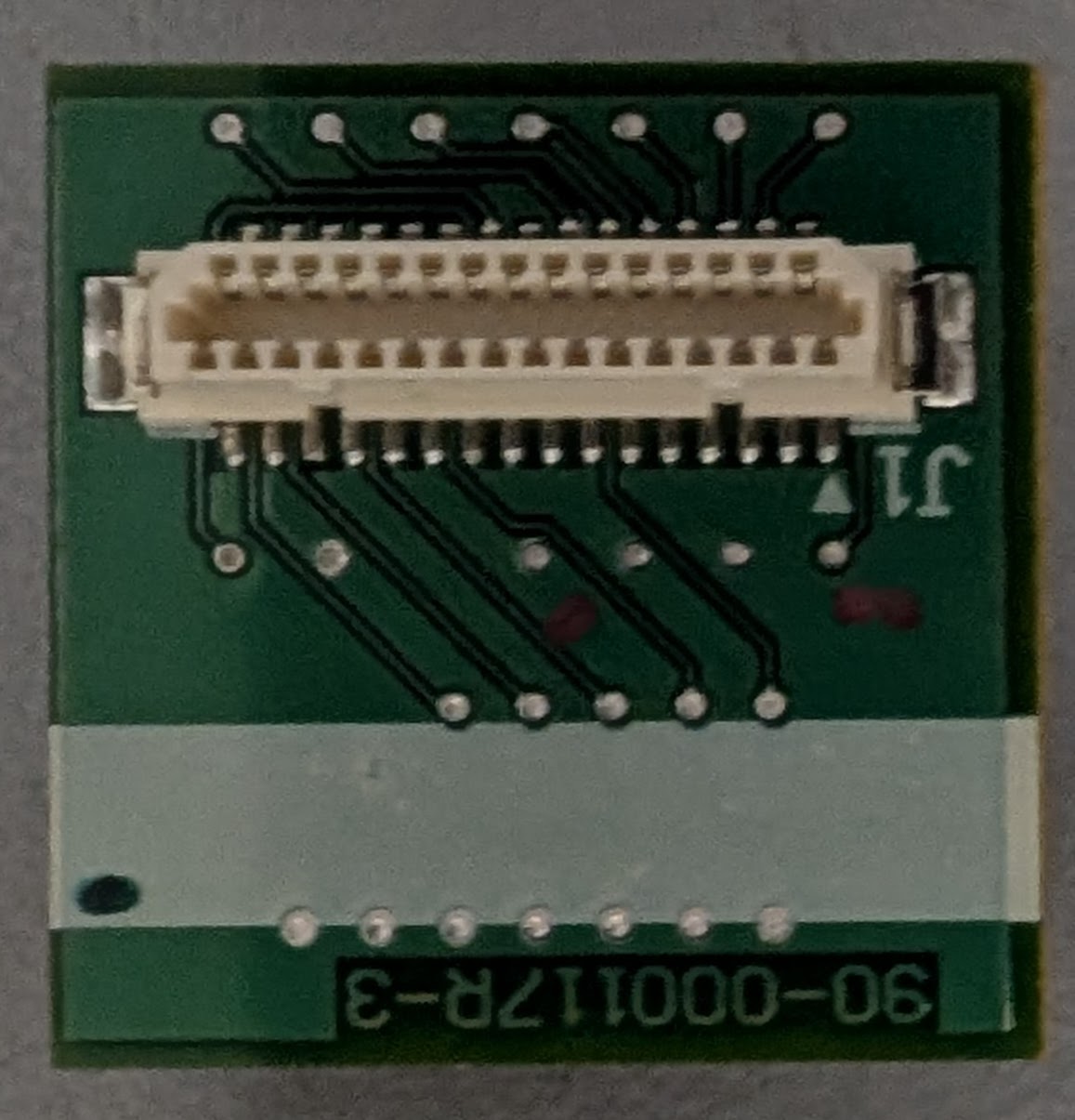

The MitySOM-AM57x Development Kits include a small break-out PCB that interfaces with the SOM J2 connector and provides a standard FPGA JTAG header compatible with standard AMD / Xilinx debug PODs as well as a second header that will work with most TI compatible JTAG PODs. Pictures of the break-out PCB are shown below.
Breakout Top Side Breakout Bottom Side

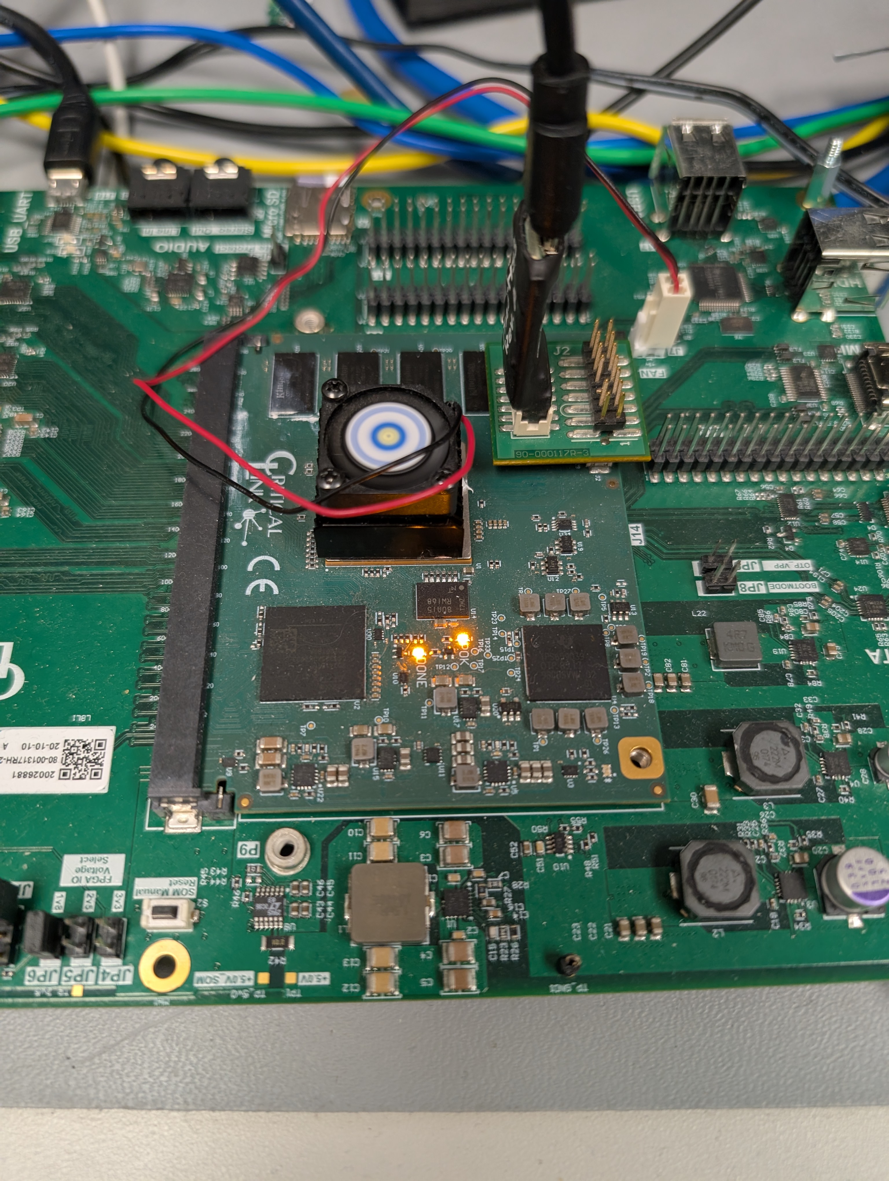

The picture below shows the board attached to a MitySOM-AM57x SOM with a Digilent USB Programming Adapter attached to the FPGA debug interface.
Connected
