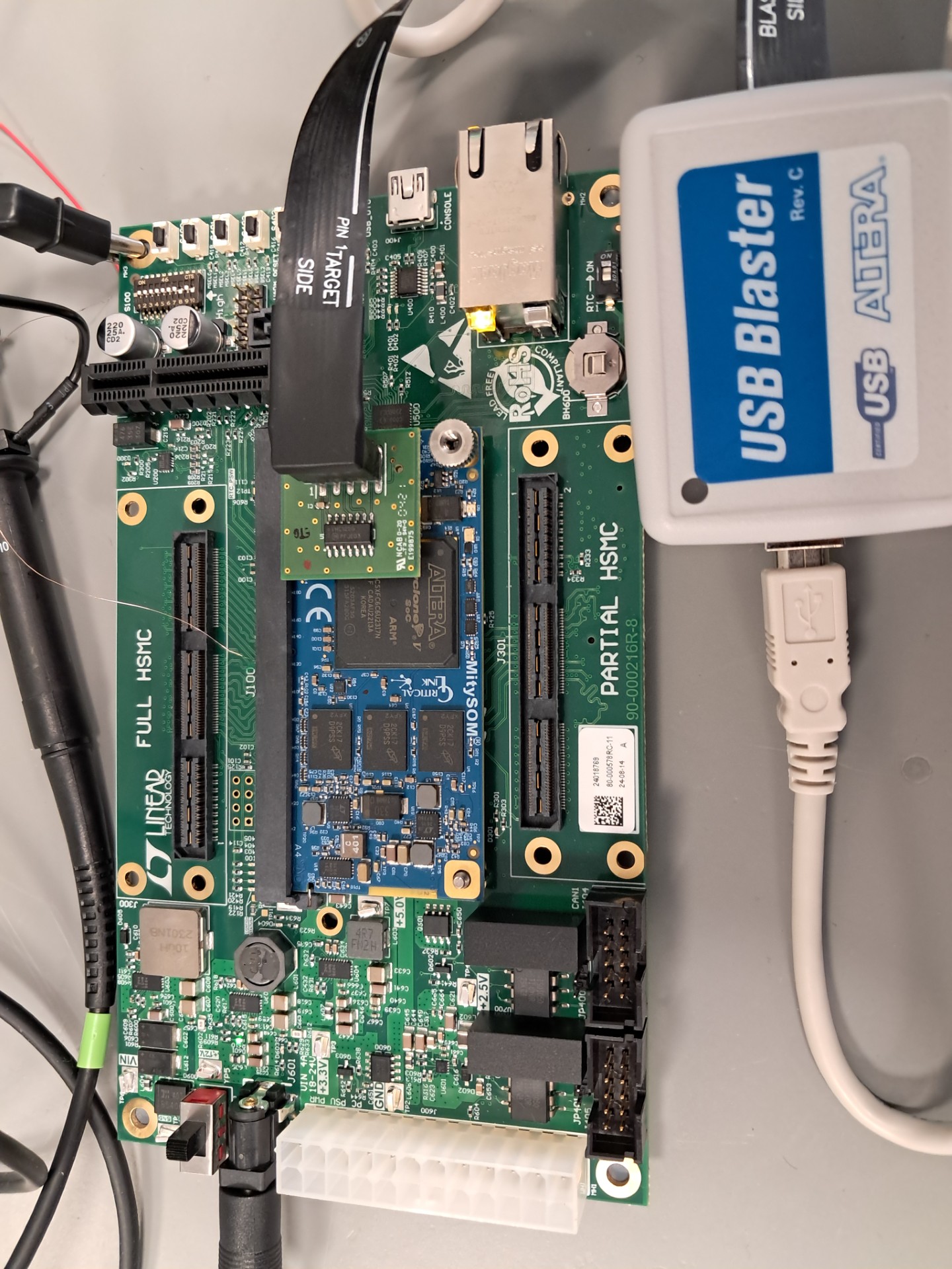

I’m trying to program a MitySOM-5CSX board via JTAG using Quartus on Windows 11, but I encounter an error immediately when starting the operation.
I'm using :
-Tool: Quartus [version], Windows 11
-Interface: USB-Blaster [I/II]
-Hardware: MitySOM-5CSX DevKit, connector J2
-Switch S100 configured as shown in the attached image (“S100_config.jpg”)
Steps Taken
- Connected the USB-Blaster to connector J2 on the DevKit.

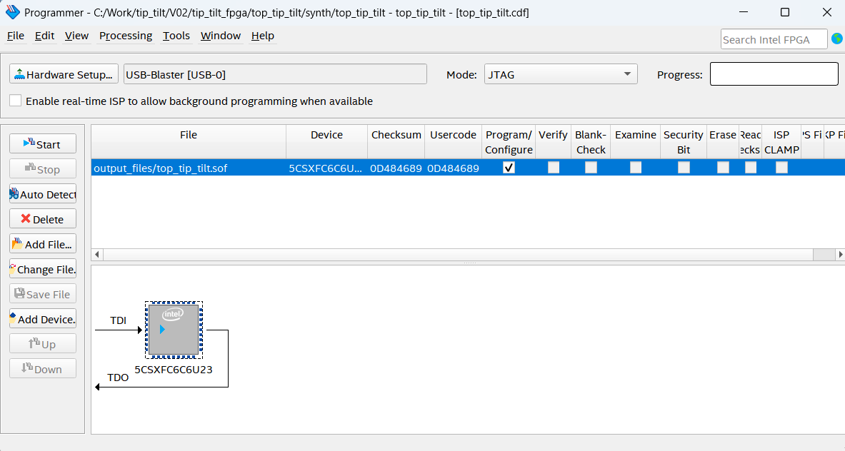

- Opened Quartus Programmer in JTAG mode as depicted in below picture.
- Clicked Start to begin programming.
Result
Quartus displays the following error:
Info (209060): Started Programmer operation at Wed Nov 12 17:11:19 2025
Error (209040): Can't access JTAG chain
Error (209012): Operation failed
Info (209061): Ended Programmer operation at Wed Nov 12 17:11:21 2025
Could you please advise on possible causes and confirm whether the S100 switch settings and the J2 connection are correct for JTAG programming on this board?
Thank you in advance for your assistance.
Best regards
RE: Clarification regarding LED 4 on MitySOM-5CSX DevKit - Added by Mike Fiorenza 4 days ago
Atef,
From your picture, it looks like you have the JTAG pod plugged in backwards. Pin 1 on your ribbon cable does not align with Pin 1 on the JTAG adapter board.
Please try rotating your pod connection and report back.
RE: Clarification regarding LED 4 on MitySOM-5CSX DevKit - Added by Atef DORAI 3 days ago
Thank you Mike, the system works by reversing the USB Blaster connection. I have another question please: Do you have a tutorial that explains how to load the HPS portion using WSL on Windows? Thanks.
