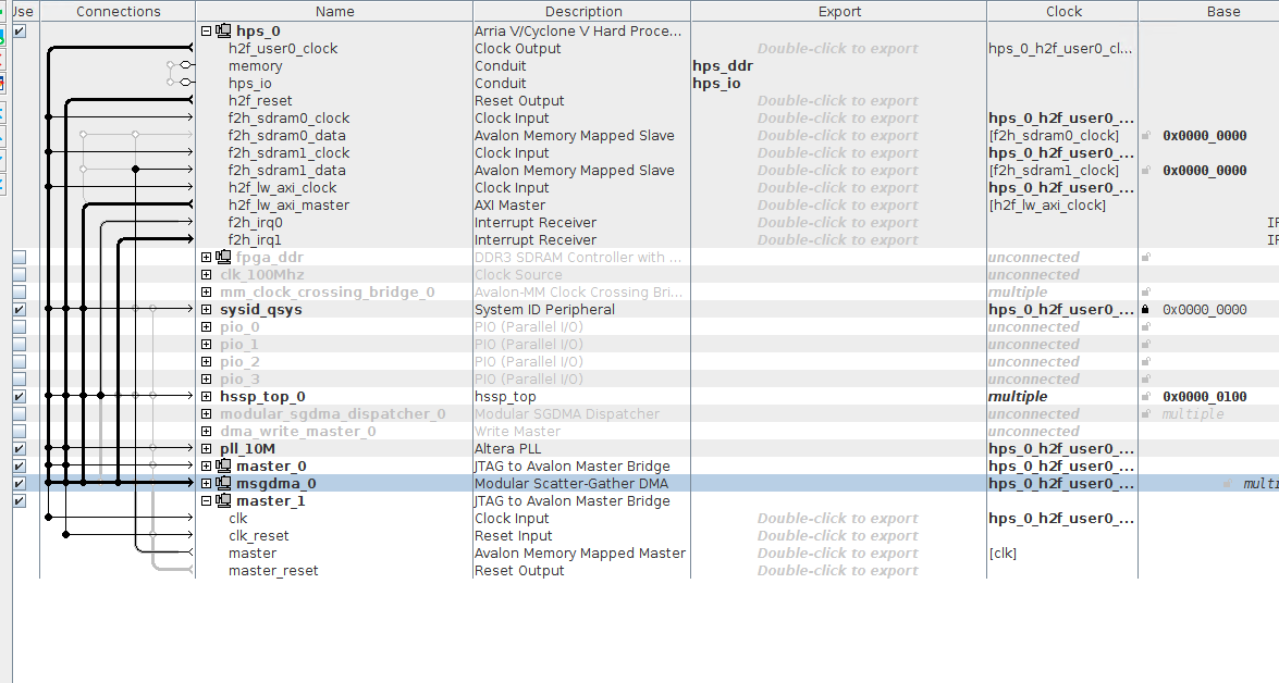

RE: JTAG_avalon_master access HPS DDR timeout - Added by Xiang Shuai 6 days ago
Hi Dan,
please see attached picture, that's a typo when I fill this page.
BR,
Xiang
