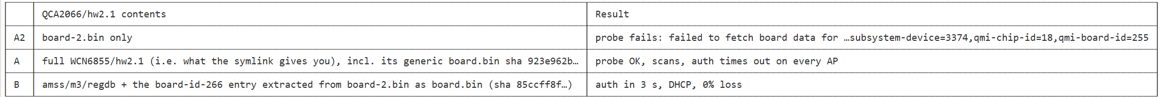

Fix 1 — firmware alias. The driver requests ath11k/QCA2066/hw2.1/* but both images ship only ath11k/WCN6855/ . Same silicon family, identical blobs; a QCA2066/hw2.1 → WCN6855/hw2.1 symlink (or shipping both dirs as linux-firmware does) fixes the probe.
Fix 2 — board data (the subtle one). After fix 1 the firmware loads ( WLAN.HSP.1.1-04685 ) and the card scans perfectly, but every authentication times out against every AP and band ( send auth ... (try 3/3) ... timed out ) and iw reg set is refused ( Failed to set the requested Country regulatory setting ). Root cause: the module reports board_id 0xff (unprovisioned OTP), while board-2.bin keys this exact card ( subsystem-device=3374, qmi-chip-id=18 ) to qmi-board-id=266 — no calibration match, so RX works but TX is effectively dead. Extracting that entry with ath11k-bdencoder and installing it as board.bin (ath11k's unconditional fallback) fixes TX immediately. Suggestion: ship a board.bin for the SX-PCEAX-M2 in the BSP.
Results after the fixes: 5 GHz VHT 2×2 link (360/243 Mbit/s PHY), iperf3 229/214 Mbit/s with zero retransmits, Bluetooth hci0 working, persistent across reboots. Identical behavior on QLI 2.0 (second unit ran single-antenna at 93 Mbit/s, as expected). Only 2.0-specific note: ~27 correctable PCIe Data-Link-Layer timeouts on the ath11k device during the first ~2 minutes after probe, then quiet, link stable at Gen3 x1 — informational, on a rev1 dev board.

DC RE: SX-PCEAX-M2 (QCA2066) bring-up on BSP 1.2 and the QLI 2.0 prelim: two fixes needed out-of-box - Added by David Cuccia 30 days ago
Hi Greg,
Yes — without Fix 2 the card cannot join any network at all. It's a subtle failure because it looks almost healthy:
• Works: driver probes, firmware loads ( WLAN.HSP.1.1-04685 ), wlan0 appears, and scanning is perfect — every nearby SSID on 2.4/5/6 GHz shows up with plausible signal levels. So "is Wi-Fi working?" checks all pass.
• Fails: every association attempt to every AP times out at the very first step: wlan0: send auth to <bssid> (try 1/3) … (try 3/3) … authentication with <bssid> timed out , and wpa_supplicant cycles CTRL-EVENT-SSID-TEMP-DISABLED reason=CONN_FAILED . NetworkManager surfaces this as the misleading "The Wi-Fi network could not be found." Also iw reg set US is rejected by the firmware ( Failed to set the requested Country regulatory setting ).
That pattern — RX fine, TX dead — is what you get when the radio is running without board-specific calibration data (the BDF). ath11k picks the BDF from board-2.bin by matching the card's identifiers; this card advertises board_id 0xff (unprovisioned OTP on the Silex module) while board-2.bin only carries an entry for subsystem-vendor=17cb,subsystem-device=3374,qmi-chip-id=18,qmi-board-id=266 . No board-id=255 match exists for that subsystem, so the firmware runs uncalibrated. Installing the …board-id=266 entry as a standalone board.bin (ath11k's unconditional fallback) made authentication succeed within seconds — same fix, same result, on both the 6.6 and 6.18 kernels.
Reproduced on two separate SX-PCEAX-M2 units, so it looks like a property of the module batch rather than a one-off. Happy to send the extracted board.bin (60 KB) or the exact ath11k-bdencoder commands if that helps you package it.

DC RE: SX-PCEAX-M2 (QCA2066) bring-up on BSP 1.2 and the QLI 2.0 prelim: two fixes needed out-of-box - Added by David Cuccia 27 days ago
Hi Greg,
Thanks for checking — so both our modules and yours read board_id 0xff ; our lot-variance idea was wrong. To pin down the difference I ran a controlled A/B on a freshly programmed BSP 1.2-based image (same NM profile, wpa-psk , regdomain US), bind-mounting three different ath11k/QCA2066/hw2.1/ contents and reloading ath11k_pci :
So the symlink works only because WCN6855/hw2.1/ ships a generic board.bin fallback ( board-2.bin has no entry for this card at board-id 255), and on our two units that generic BDF gives RX-only behaviour. Ours were −52/−56 dBm from the AP, so it isn't range on our side.
Two things that could explain why yours passes:- your module may carry a different OTP calibration such that the generic BDF is "good enough" — could you check sha256sum /lib/firmware/ath11k/WCN6855/hw2.1/board.bin on your image and whether dmesg | grep -i "board data\|board.bin" shows a fetch from board-2.bin or the fallback?
- If you have a minute, iw dev wlan0 link and iw dev wlan0 station dump | grep -E "signal|tx (bitrate|retries|failed)" while connected would show whether TX retries are elevated even when the association succeeds.
Either way, shipping the board-id-266 BDF as QCA2066/hw2.1/board.bin in the BSP costs 60 KB and made both of our units work out of the box; we now build it into our own image. Happy to send the exact file.
