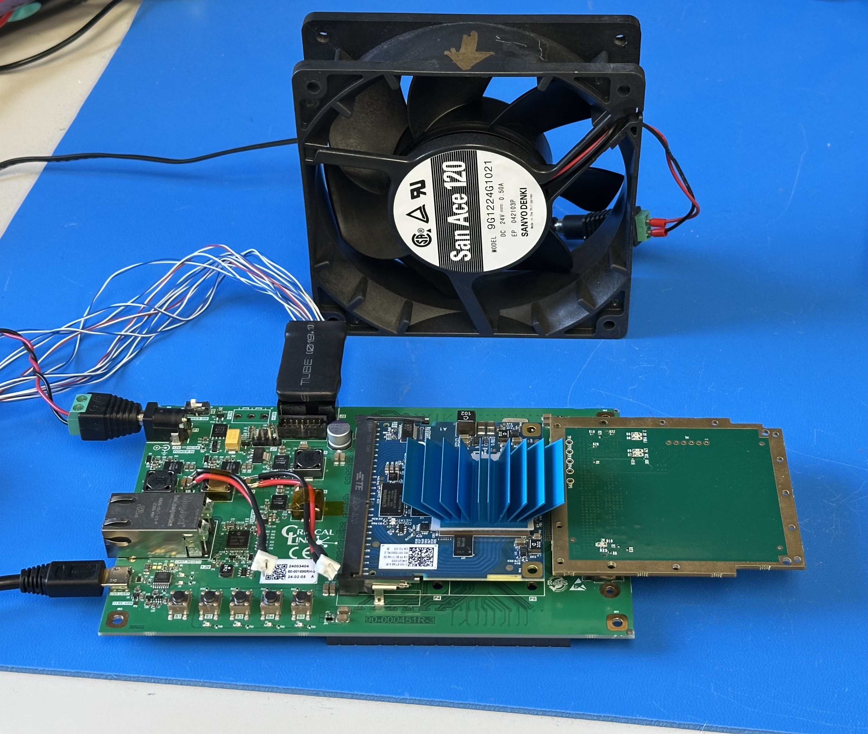

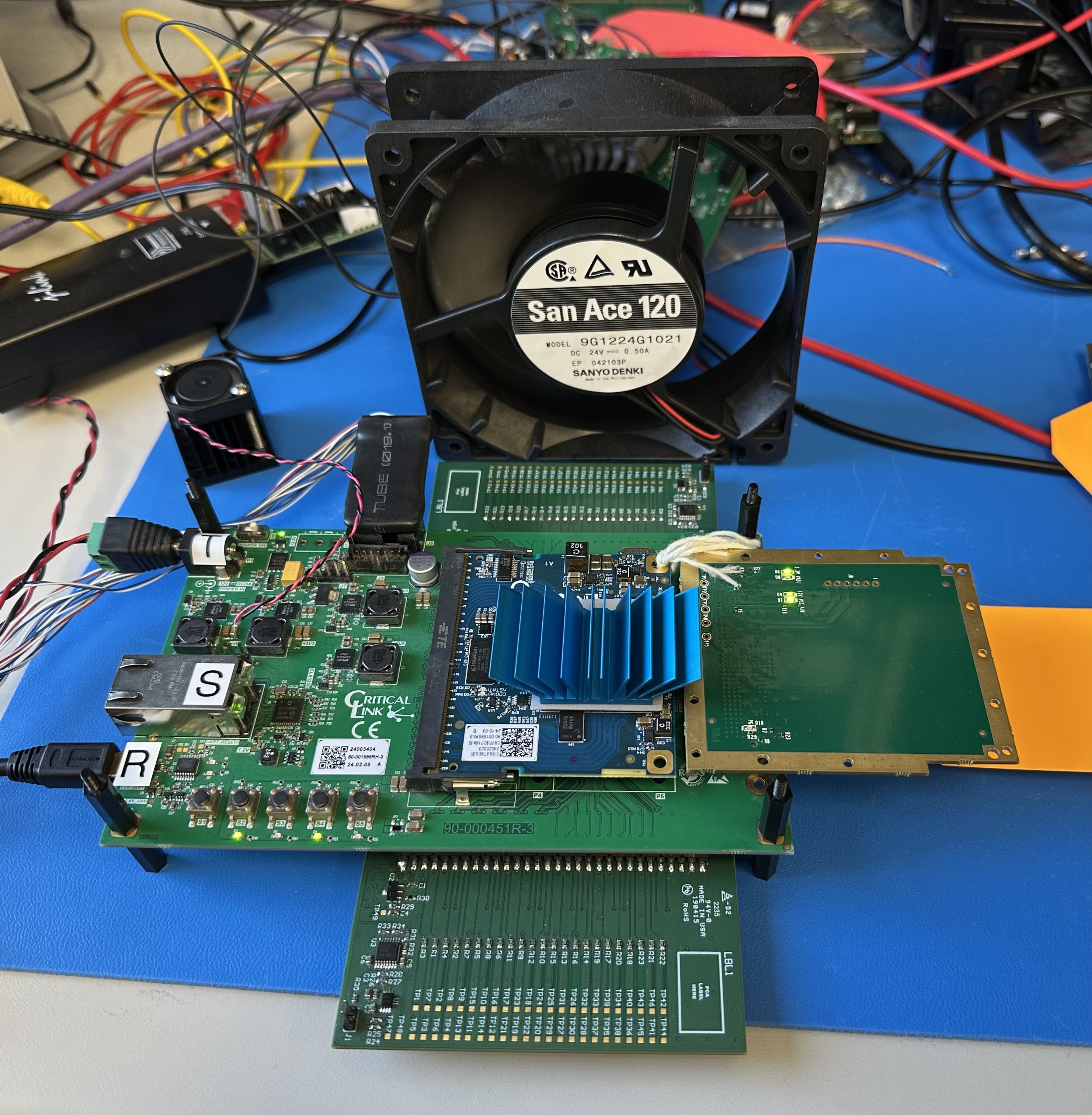

Test Setup¶
Fan placement and setup during testing:
