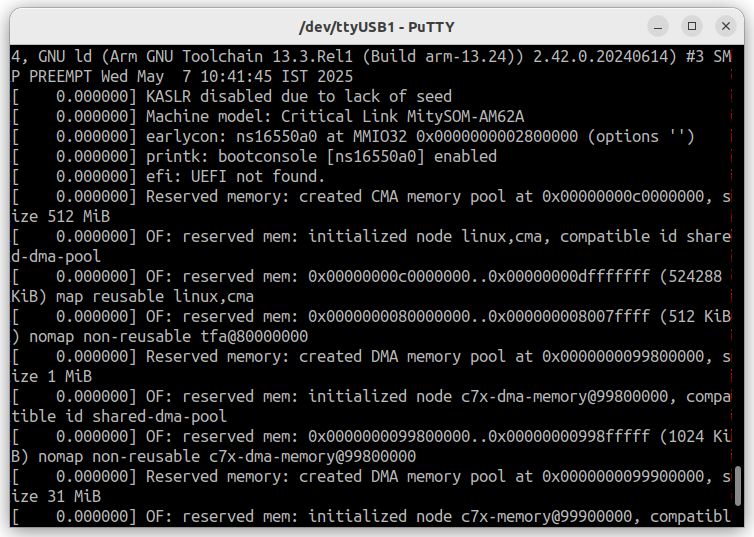

RE: Enable DDR ECC in Am62A processor - Added by Rajkumar Dumala 1 day ago
Hello Mike,
I reduced the CMA size to 512 MiB; however, the issue remains the same.I am providing the image for your reference.

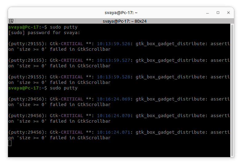

It was my mistake—I shared the wrong screenshot earlier. You can find the correct one attached with this message.

RE: Enable DDR ECC in Am62A processor - Added by Michael Williamson 1 day ago
Hi Rajkumar,
From this link:
https://support.criticallink.com/redmine/projects/mitysom_am62x/wiki/Enabling_DDRSS_ECC
The maximum memory address is approximately 0xFFFFFFFF * 8 / 9 ~= 0xE38E38E2
It looks like the maximum CMA space you are calling for reaches up to 0XE000000, so maybe that's OK now?

[ 0.000000] OF: reserved mem: initialized node c7x-dma-memory@99800000, compatible id shared-dma-pool
[ 0.000000] OF: reserved mem: 0x0000000099800000..0x00000000998fffff (1024 KiB) nomap non-reusable c7x-dma-memory@99800000
[ 0.000000] Reserved memory: created DMA memory pool at 0x0000000099900000, size 31 MiB
[ 0.000000] OF: reserved mem: initialized node c7x-memory@99900000, compatible id shared-dma-pool
[ 0.000000] OF: reserved mem: 0x0000000099900000..0x000000009b7fffff (31744 KiB) nomap non-reusable c7x-memory@99900000
[ 0.000000] Reserved memory: created DMA memory pool at 0x000000009b800000, size 1 MiB
[ 0.000000] OF: reserved mem: initialized node r5f-dma-memory@9b800000, compatible id shared-dma-pool
[ 0.000000] OF: reserved mem: 0x000000009b800000..0x000000009b8fffff (1024 KiB) nomap non-reusable r5f-dma-memory@9b800000
[ 0.000000] Reserved memory: created DMA memory pool at 0x000000009b900000, size 15 MiB
[ 0.000000] OF: reserved mem: initialized node r5f-dma-memory@9b900000, compatible id shared-dma-pool
[ 0.000000] OF: reserved mem: 0x000000009b900000..0x000000009c7fffff (15360 KiB) nomap non-reusable r5f-dma-memory@9b900000
[ 0.000000] Reserved memory: created DMA memory pool at 0x000000009c800000, size 1 MiB
[ 0.000000] OF: reserved mem: initialized node r5f-dma-memory@9c800000, compatible id shared-dma-pool
[ 0.000000] OF: reserved mem: 0x000000009c800000..0x000000009c8fffff (1024 KiB) nomap non-reusable r5f-dma-memory@9c800000
[ 0.000000] Reserved memory: created DMA memory pool at 0x000000009c900000, size 30 MiB
[ 0.000000] OF: reserved mem: initialized node r5f-dma-memory@9c900000, compatible id shared-dma-pool
[ 0.000000] OF: reserved mem: 0x000000009c900000..0x000000009e6fffff (30720 KiB) nomap non-reusable r5f-dma-memory@9c900000
[ 0.000000] OF: reserved mem: 0x000000009e800000..0x000000009fffffff (24576 KiB) nomap non-reusable optee@9e800000
[ 0.000000] OF: reserved mem: 0x00000000a0000000..0x00000000a0ffffff (16384 KiB) nomap non-reusable edgeai-rtos-ipc-memory-region
[ 0.000000] Reserved memory: created DMA memory pool at 0x00000000a1000000, size 32 MiB
[ 0.000000] OF: reserved mem: initialized node edgeai-dma-memory@a1000000, compatible id shared-dma-pool
[ 0.000000] OF: reserved mem: 0x00000000a1000000..0x00000000a2ffffff (32768 KiB) nomap non-reusable edgeai-dma-memory@a1000000
[ 0.000000] OF: reserved mem: initialized node edgeai_shared-memories, compatible id dma-heap-carveout
[ 0.000000] OF: reserved mem: 0x00000000a3000000..0x00000000adffffff (180224 KiB) map non-reusable edgeai_shared-memories
[ 0.000000] Reserved memory: created DMA memory pool at 0x00000000ae000000, size 288 MiB
[ 0.000000] OF: reserved mem: initialized node edgeai-core-heap-memory@ae000000, compatible id shared-dma-pool
[ 0.000000] OF: reserved mem: 0x00000000ae000000..0x00000000bfffffff (294912 KiB) nomap non-reusable edgeai-core-heap-memory@ae000000
[ 0.000000] Internal error: synchronous external abort: 0000000096000010 [#1] PREEMPT SMP
[ 0.000000] Modules linked in:
