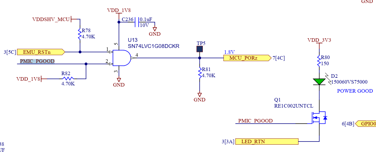

This is a snippet from the SOM schematic related to the Power Good LED and the LED_RTN Net:
As you can see, the PMIC_PGOOD is AND-ed into the main MCU_PORz. It is an open-drain output from the PMIC pulled to 1.8V via 4.7K and is also used to drive the FET. It would seem that the FET switching on your board must be perturbating the PMIC_PGOOD at the gate of Q1 and and causing the MUC_PORz to be driven low, based on your description. Looking at the schematic, we probably should have added a resistor at the input to the gate on Q1 in the design (the gate capacitance is probably passing the switch of your FET into the gate signal / bouncing PMIC_PGOOD).
Not sure if there is an easy workaround without modifying the SOM (which, if we have to spin it in the future, I will definitely add). We haven't had anyone try to actively switch that return line. We mostly put it there because we have some customers that don't want to bleed the power from the Power Good resistor during operation (in sleep mode).
-Mike

That explanations seems probable, if I have any free time coming up I'll play around with the circuit on our side to get it working reliably.
For the time being we'll continue to not switch LED_RTN.
Thanks for the rapid reply!
RE: SOM_62P Reset on LED_RTN - Added by Michael Williamson about 2 months ago
Wondering if you could add a LPF filter (cap + R) across your FET to make the switch less aggressive. Kind of hacky, but it might work.
