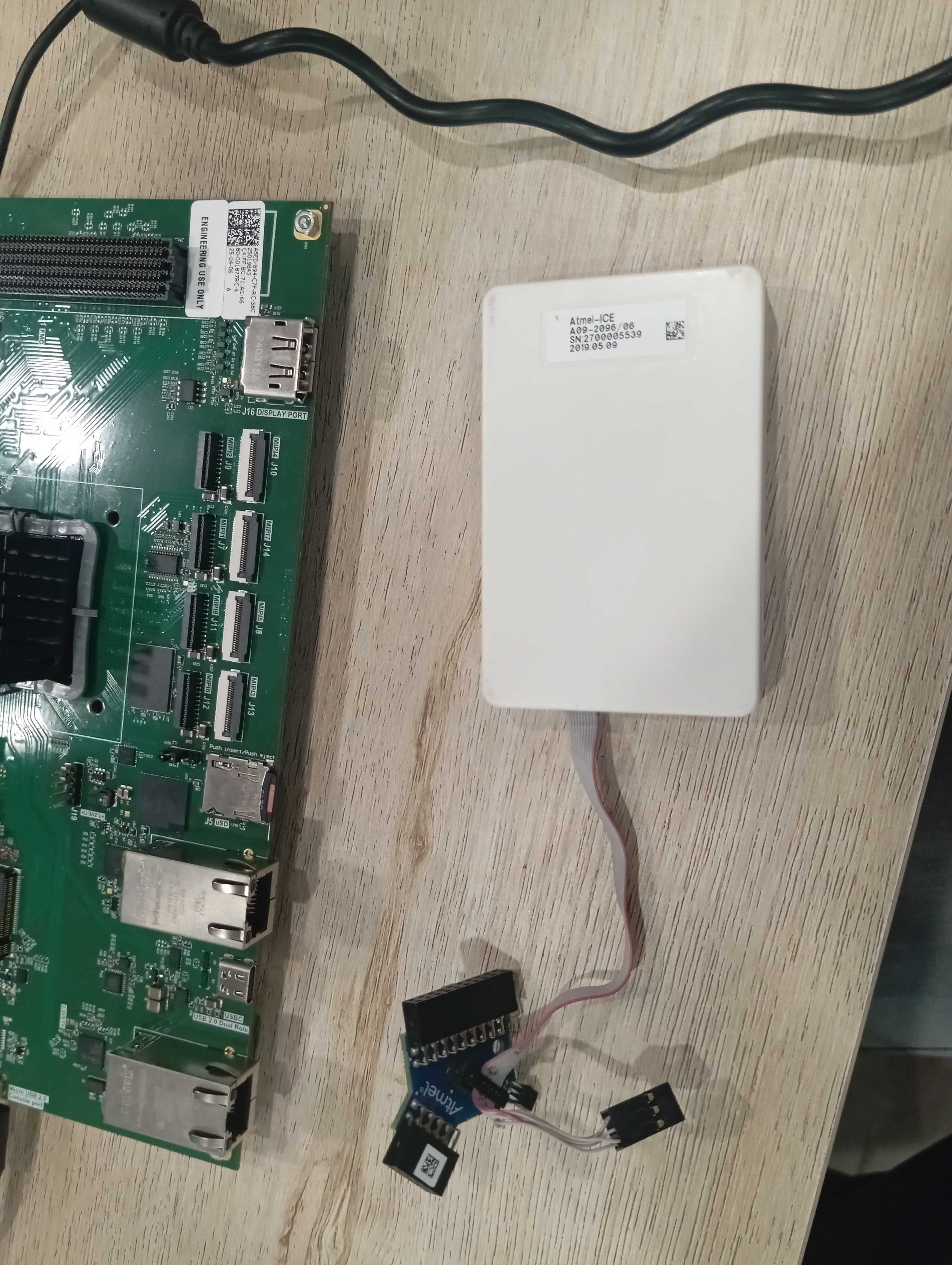

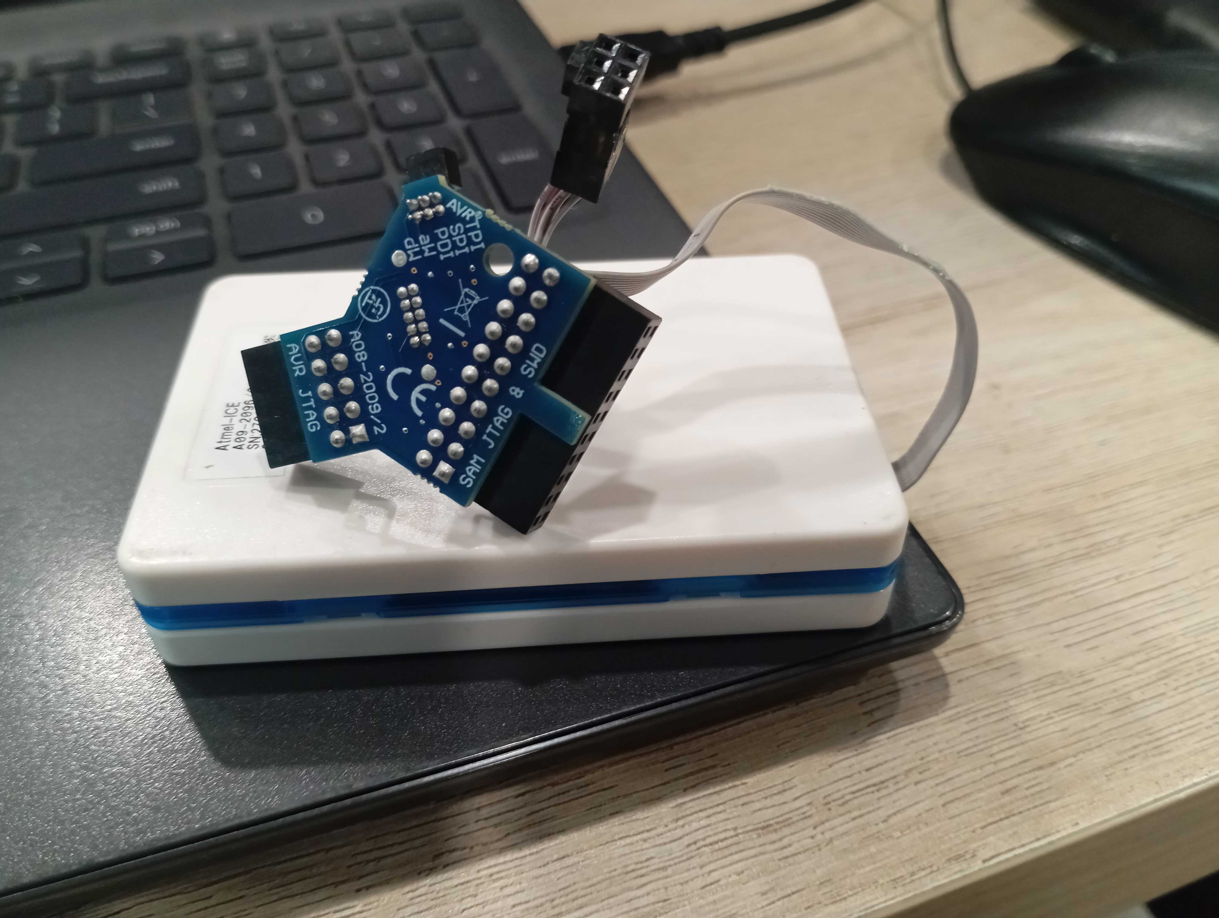

TT RE: rbf files from example project gives Error while booting - Added by Talha Tahir 11 days ago
Thank you for pointing out the issue. The link suggests to program the QSPI NOR via Altera USB-II Blaster.
In the dev-kit I didn't receive any Altera USB-II Blaster. I only received the board, power supply and it's cable, ethernet cable, mircoUSB cable for console output and a fully loaded SD card.
It will take me a couple of days to acquire an Altera USB-Blaster II. In the meantime, is there any supported/documented procedure to access and update the QSPI NOR flash directly via HPS running linux?
Apart from that, I currently have an Atmel-ICE Programmer/Debugger (Model: A09-2096/06) along with its SAM JTAG breakout adapter board (attached images below). Since I do not currently have the USB-Blaster II on hand, is it possible to use this Atmel-ICE programmer with Quartus to flash the .jic file onto the board, or is an official Altera USB-Blaster II strictly required for JTAG programming on this board?
MW RE: rbf files from example project gives Error while booting - Added by Michael Williamson 11 days ago
I am sorry for the inconvenience.
You should be able to use this device instead of a Blaster device if that is a problem:
https://www.digikey.com/en/products/detail/trenz-electronic-gmbh/TEI0004-02/22081849
If it is quicker or easier to get.
I don't think Quartus will support the Atmel-ICE programmer.
