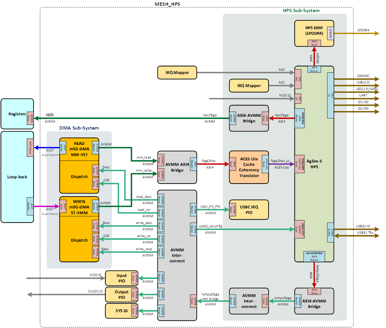

Also another question:
I’ve build a detailed block diagram of the DMA example design:
[cid:]
I’ve created a project, based on DMA example design with following modifications:
  • I removed DMA AVST Generator and Checker and made a loopback connection
  • I added in the HPS configuration: HPS2FPGA AXI4 Interface and AXI4-to-AVMM Bridge – we need this interface to access the registers
    Basically, this is a step to our project and how we are planning to use DMA example design:
    [cid:]
    Can you please suggest us what are the next steps that we need to do?? I’m asking mostly in term of SW. For the FPGA perspective, I’ve already compiled the modified project and run make jic script and got the files.
    I’m sorry, maybe I’m asking very basic questions, but this is our first project where we are using HPS.
Max
