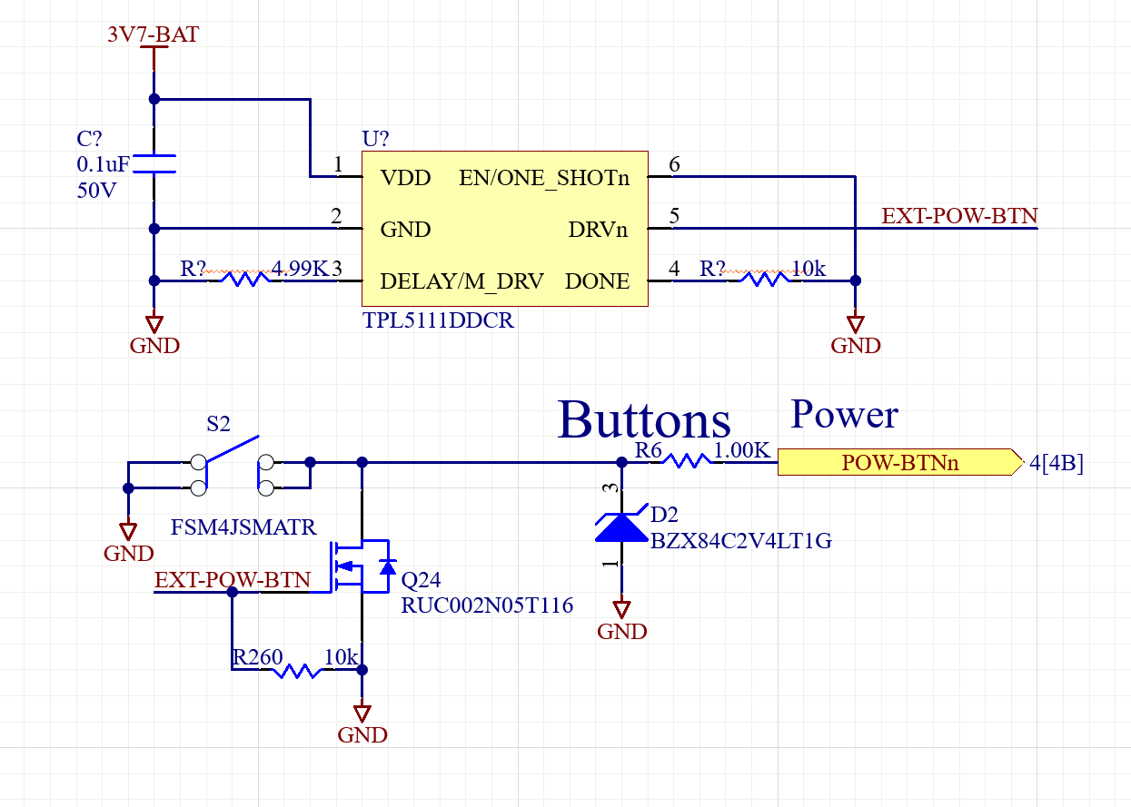

One Shot Mode
In One Shot Mode, after power is applied to the timer, it produces a single pulse. To accomplish this, EN/ONE_SHOTn should be connected to GND. The schematic is shown below. This is a snippet of the MitySOM-QC Dev Kit with the addition of the TPL5111.
Note that if the SOM powers down for any reason then the TPL5111 will NOT turn the SOM back on until the voltage on 3V7-BAT is removed and re-applied.

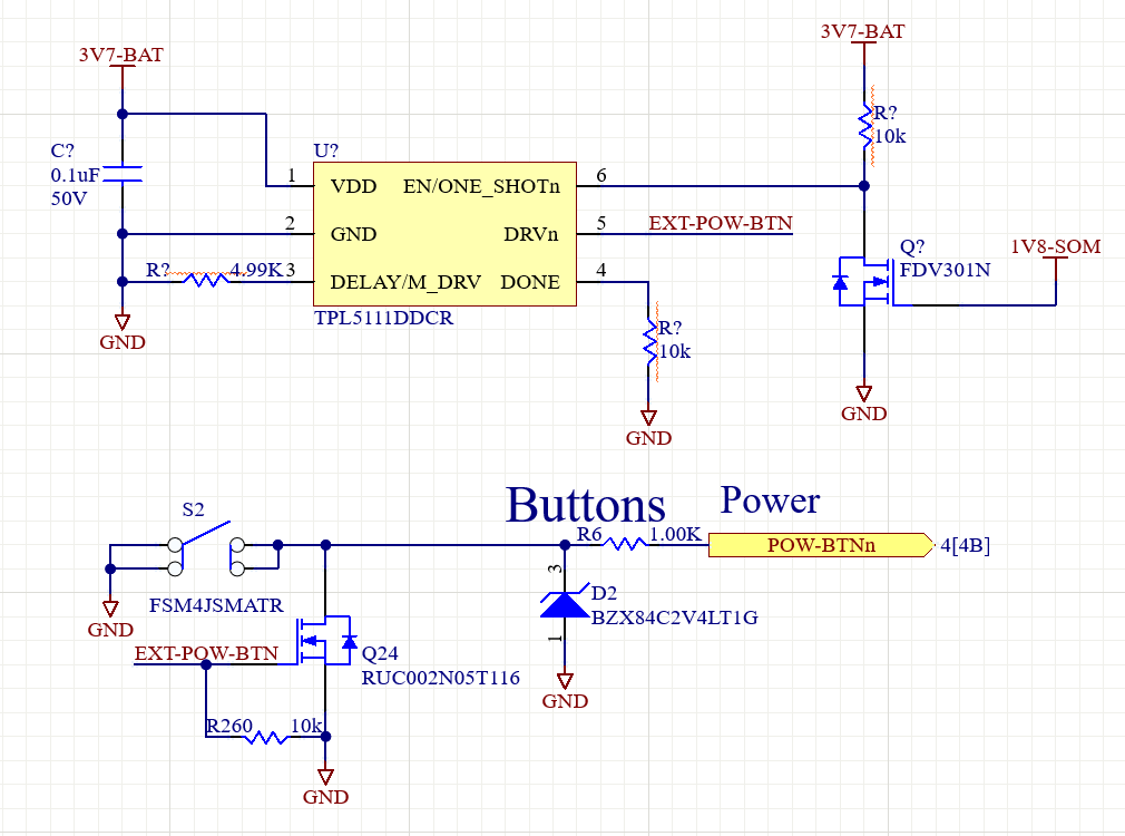

Timer Mode
In Timer Mode, after power is applied to the timer, it will continue to produce pulses on DRVn at regular intervals until the EN/ONE_SHOTn signal is pulled low by the SOM, indicating successful boot. To accomplish this, EN/ONE_SHOTn should be connected to VDD through a pull up resistor and connected to ground with an NMOS FET. The gate of the FET should be connected to either a GPIO or 1V8-SOM so that when the SOM is booted, the TPL5111 is disabled.
Note that if the SOM powers down for any reason then the TPL5111 will re-enable turning the SOM back on as long as as voltage is present on 3V7-BAT.
