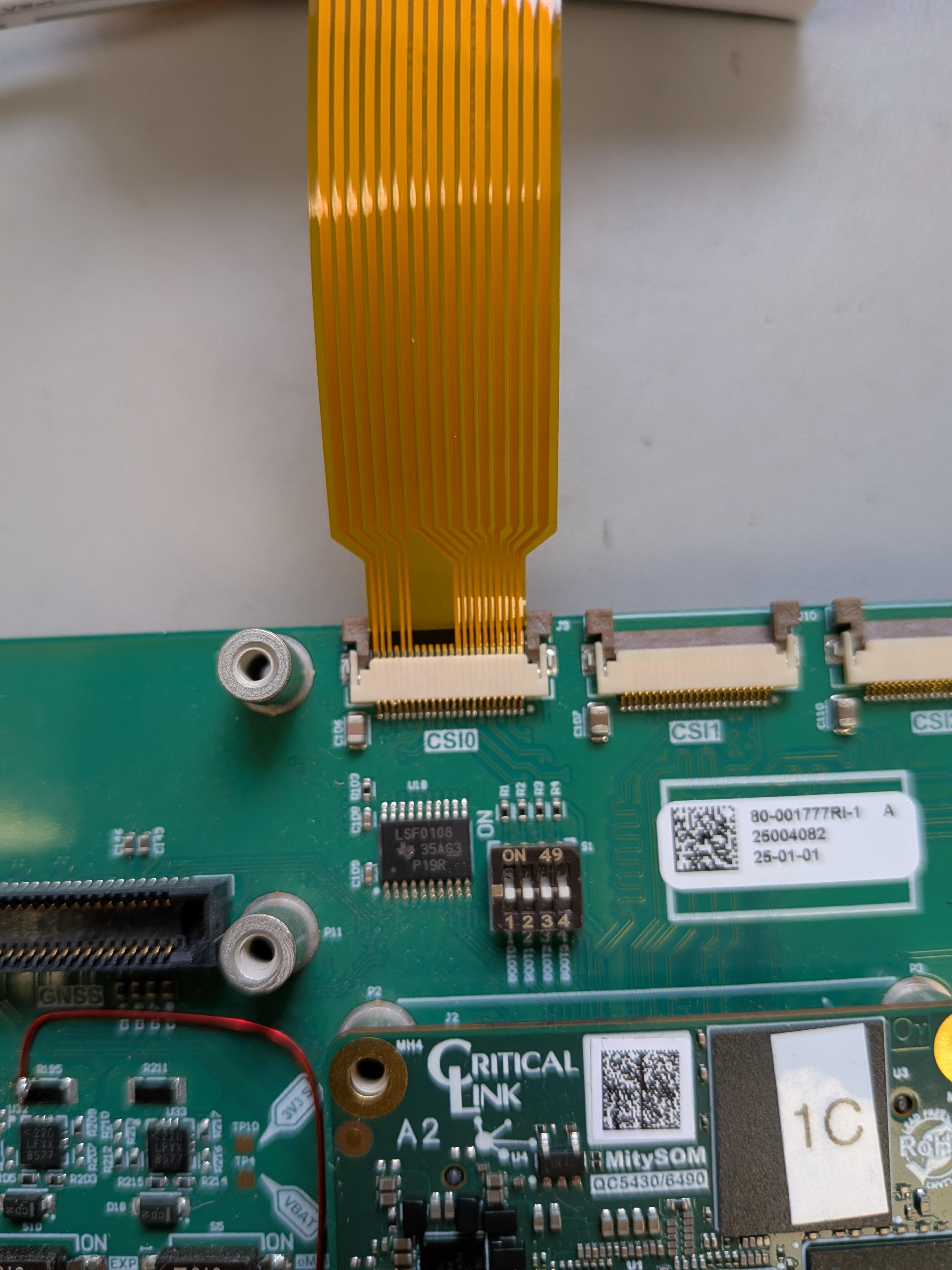

Note that the connector on the Development Board is a Hirose FH12A-22S-0.5SH(55) (22 pin 0.5 mm pitch).
Also note that when installing the cable the dark brown latch on the connector should be up and the cable should be inserted between the dark brown latch and light brown body with the pins on the cable facing up. Once the cable is in position the dark brown latch should be pushed down to secure the cable.
Please see the picture below for an example of a properly connected cable:
