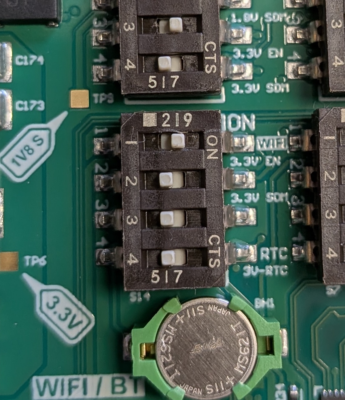

If a Rev 1 or 2 Development Board is being used, ensure that Switch S14 is set properly, otherwise for a Rev 3 or newer, ensure that Switch S5 is set properly.
  • Rev 1 or 2 (S14 - left image):
    • Switch 1 should be set to enable the 3V3 WIFI from the DC supply
    • Switch 2 should NOT be set for Rev 1 or 2 of the Development Board as 3.3V from the SOM may actually be a higher volage. See MitySOM-QC6490 Development Kit Datasheet
  • Rev 3 or newer (S5 - right image):
    • Switch 3 should be set to enable the 3V3 WIFI from the DC supply
    • Switch 4 can be set for Rev 3 or newer of the Development Board to power the WiFi interface from the SOM's 3.3V rail instead of from the DC supply

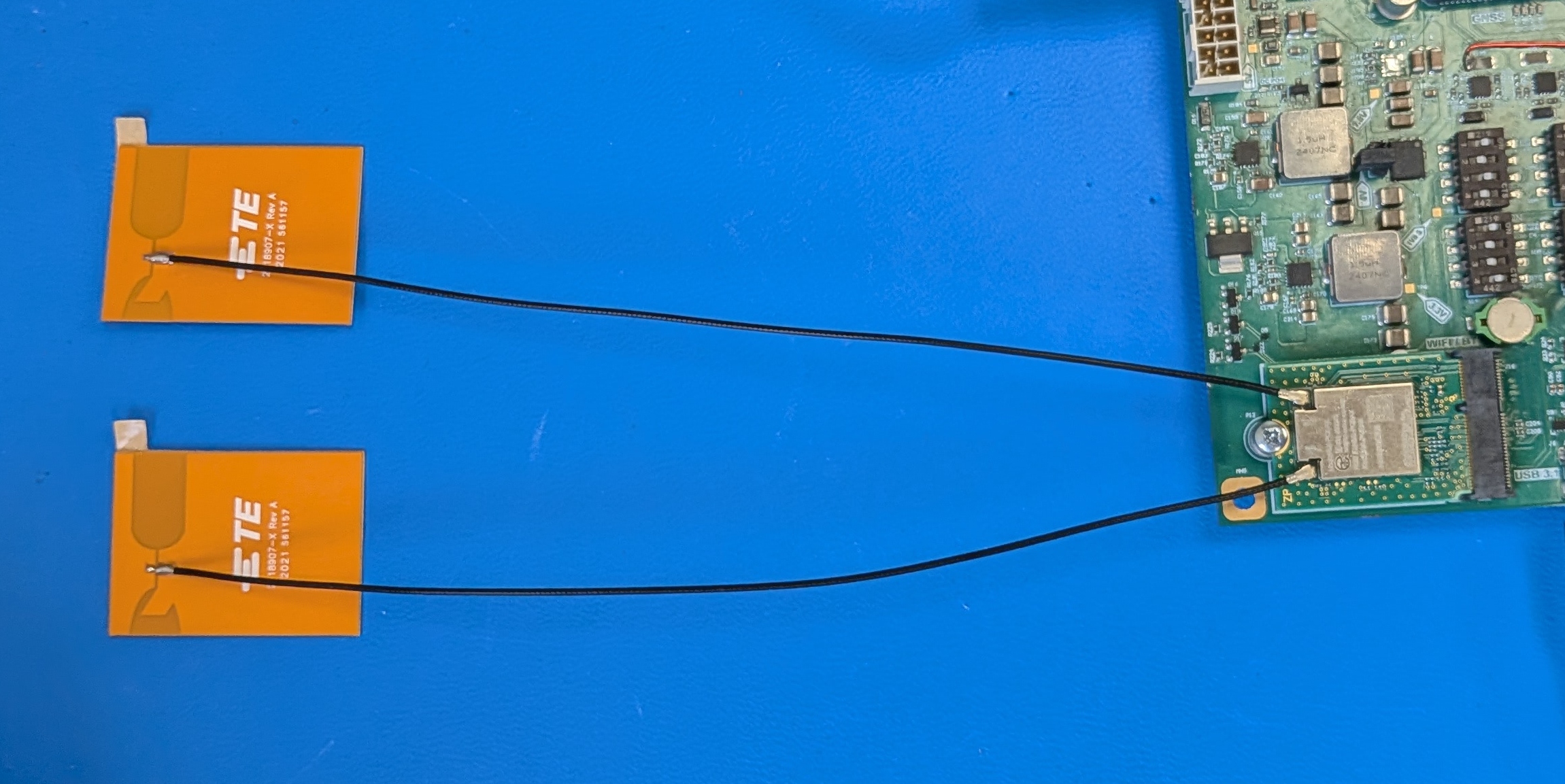

Using the Silex SX-PCEAX-M2 to connect to a Wi-Fi network
  1. If you do not already have a Silex SX-PCEAX-M2 one can be obtained here
  2. Make sure the antennas are connected to the SX-PCEAX
  3. Insert the radio module into J16
  4. If you have a Rev 1 Development Board, use an M2.5 screw to secure the module. If you have a Rev 2 Development Board, use an M2 screw to secure the module.
  5. Boot the Dev Kit
