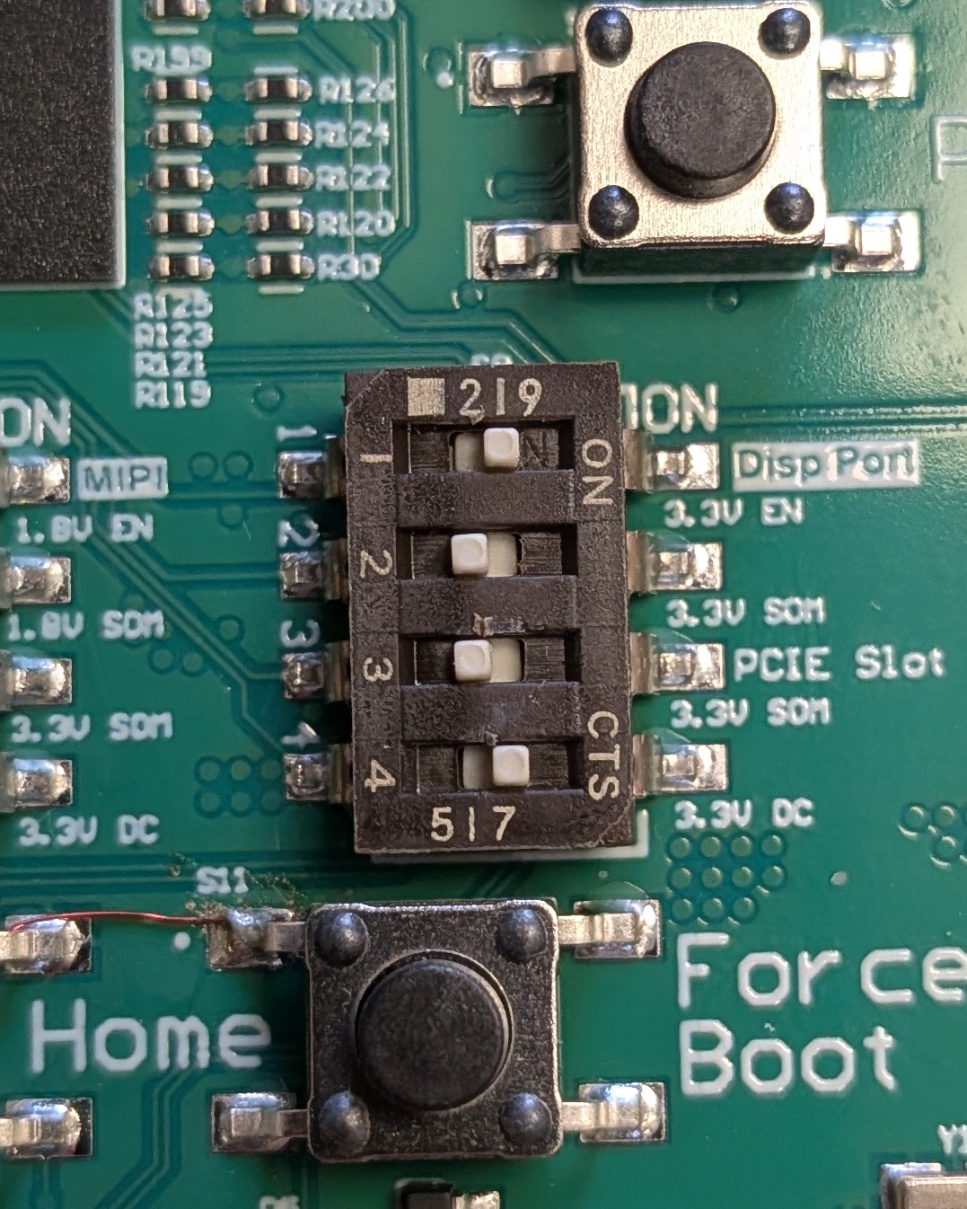

Ensure that Switch S9 is set properly.
  • Switch 1 should be set to enable the 3V3 DP from the DC supply
  • Switch 2 should NOT be set for Rev 1 or 2 of the Development Board as 3.3V from the SOM may actually be a higher volage. See MitySOM-QC6490 Development Kit Datasheet.
    • For Rev 3 onward, Switch 2 can be either set or not set.
      • If Switch 2 is not set the 3.3V comes from the DC supply on the Development Kit
      • If Switch 2 is set the 3.3V comes from the SOM
  • Note: Switch 3 PCIe "3.3V SOM" must be OFF for DisplayPort to work properly on Rev 1, Rev 2, and Rev 3 versions of the Development Board.
  • Note: Switch 4 PCIe "3.3V DC" must be ON for DisplayPort to work properly on Rev 1, Rev 2, and Rev 3 versions of the Development Board.
