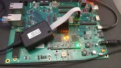

The JTAG (J2) interface is located on the SOM and requires an debug adapter board. The board will contain a TI14 connector (J2) for the ARM and DSP and a Xilinx 14-pin connector (J3) for the FPGA.
Non-fpga modules¶
Note: AM57x non-FPGA SOMs have a cTI 20-pin connector instead. The JTAG emulator is plugged into this without the above "debug adapter board".
There is a known issue with the Rev1/2 hardware. Pins 4(TDIS) and 8(GND) need to be shorted for the debugger to attach. These are across the key.

ARM: TI XDS200 $295, TI XDS110 $99, Blackhawk XDS560 v2 $995

- Open Code Composer (CCS)
- File -> New -> Target Configuration File
- File name: AM5728_XDS200.ccxml
- Check "Use shared location"
- Click Finish
- Edit opened Target Configuration
- Connection: Select the correct debug probe.
"Texas Instruments XDS2xx USB Debug Probe" for the XDS200 - Board or Device: AM5728
- Select Save
- Select Test Connection
