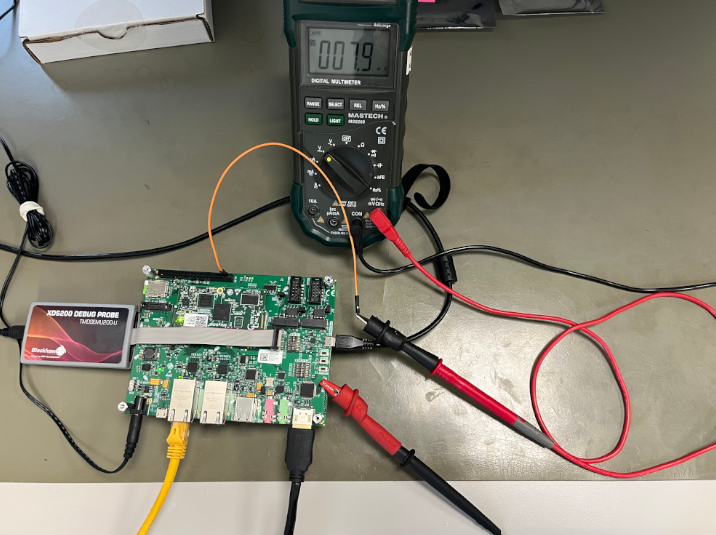

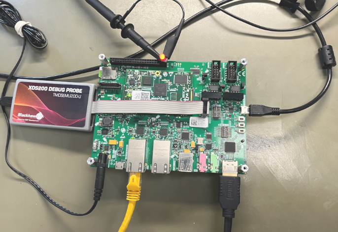

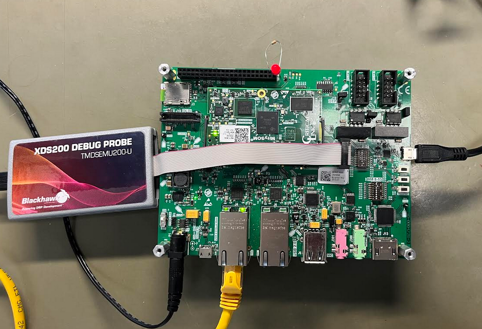

- The following material will be needed to complete this example
- MitySOM-AM62x
- MitySOM-AM62x Dev Board
- XDS200 Debug Probe
- Oscilloscope
- Two wire LED Bulb
- 200-400 ohm resistor (to reduce stress on the SOMs input/output)
Complete Setup (Oscilloscope is out of picture)

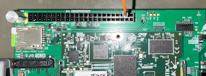

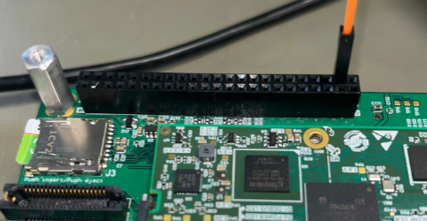

GPIO Expansion Close Up

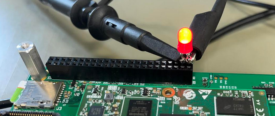

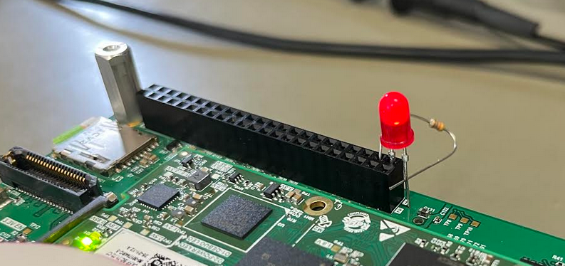

Insert one end of the 200-ohm resistor into pin 3 and the short leg (cathode) of the LED into pin 1. Then, connect the other end of the resistor to the long leg (anode) of the LED in series.
Note: A breadboard can be used to ensure wires do not disconnect throughout the lab

Connect the XDS200 Debug Probe to the Jtag port (J9) on the dev board

The target configuration should now connect to the board and load the toggle_led.out program. To run the program hit the "Resume (F8)" button in the toolbar.
The LED should now be blinking, and the oscilloscope should show the GPIO’s voltage transitioning from high to low and low to high
