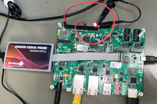

Complete Setup (Oscilloscope is out of picture)

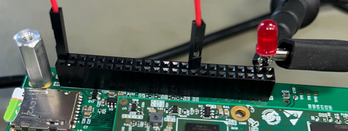

GPIO Expansion Close Up
Insert the long wire of the LED into pin 3 and the shorter GND wire into pin 1.
For this example, we will be using a wire instead of a button. Insert one end of the wire into pin 17 and the other end into pin 45.
WARNING: Do not insert either end of the male-to-male header wire into pin 46, as it is a 12V supply and could damage the GPIO pin—or worse, the chip.

The target configuration should now connect to both PRU's and load the button_led_0.out and button_led_1.out programs. To run these programs click on the "main() at button_led_X.c: ..." and hit the "Resume (F8)" button in the toolbar.
As you make have already observed from reviewing the code, the program is active low, which means the led will only toggle when the GPI voltage is unknown or grounded.
If the male-to-male header wire is connected to pin 45 the LED should stop blinking and remain at its last state (on or off). To toggle/blink the LED disconnect the wire from pin 45.
The LED should now be blinking, and the oscilloscope should show the GPIO’s voltage transitioning from high to low and low to high
