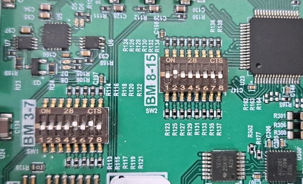

Reference: TRM Section 5.3 "Boot Mode Pins"
| B9 | B8 | B7 | B6 | B5 | B4 | B3 |
| 0.85V CoreV (0) | DFU (0) | No Swap (0) | 1 | 0 | 1 | 0 |
Note: B9 may need to be changed depending on the Revision of the SOM. You can check TP9 immediately after power on to see which voltage B9 should be set to.

 - Set the boot switches to DFU mode. Switches: SW1 = [00001010] SW2 = [01000000].
